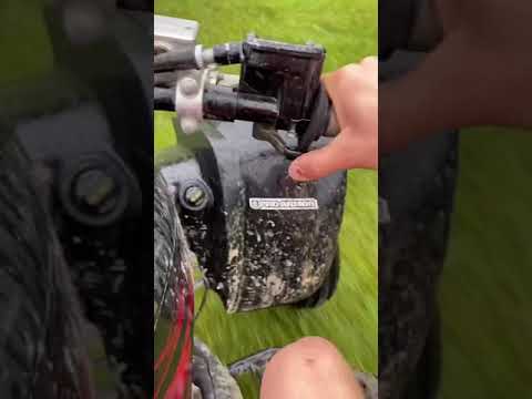

I have to start with this because I suspect this may be part of the problem, unfortunately it has an eBay carb:( the carb is clean though and I’ve messed with the air fuel ratio screws and cleaned up the problem a little bit. The problem is when I get on the gas hard it stumbles at the low rpms and cleans up once it revs up. Im curious if there’s a way to fix it with the current eBay carb. I’ll attach link of video of it bogging below. If you have any info please help me out thanks!
Quad is bone stock

oem carbs are hard to get and the ones that are available are stupid expensive. I also agree that oem is better but that doesn’t help for someone that doesn’t have them or can not afford the cost.
That bog/ hesitation sounds like a rich condition that should be able to fix with some time jetting and adjusting the carburetor. Start by lowering the needle (raising the clip) and see if that helps. If it helps but does not fix it you may need a smaller main jet.

The carbs have three circuits that control air/fuel ratio at different areas of throttle:
Pilot jets and fuel screws control idle to about 1/4 throttle,
And coming onto and off of throttle.
Needles control between 1/4 and 3/4 throttle.
Main jets affect from 3/4 to wide open throttle.
Your symptoms suggest an issue with the pilot circuit… the pilot jet orifices are tiny and subject to plugging. I’d suggest cleaning them - Rodding them out with strands of copper speaker wire and spray carb cleaner.
If they’re clean, then test for too rich or lean by turning on the choke fully or partially - does problem get better or worse? Better? Turn out the fuel screws (CCW) a bit… worse? Turn them in.
Also, you must test with the air filter and air box fully intact else you’ll be way too lean.
Keep testing and repeating.
