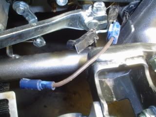

I was cleaning my quad the other day and guess what I found?
A damn scotchlock!!!?? On my brand new $8000 quad!? I couldn't belive my eyes. Well I have soldered the wire up and its all good now, but I still don't believe a dealer would let this go out the door. Its gonna cause a problem sooner than later. I know its not a vital circuit or anything but I had to rant. Dealer will be getting an earful...

That blue connetor on the end is not original either. It should have one like the black one above it.
1,192 Posts
Yeah I noticed that also. I'm gonna go to the dealer Saturday and have him get me the right one. But I will install it myself.

A scotchlock is a wire connector that you just squeeze with a pair of pliers and the metal tab slices through the insulation to make a connection. They are in no way waterproof and with all the vibration your lucky if the even stay connected. Its the lighter blue connector about 3 inches up the wire in the pics. I am guessing that the dealer maybe stole that connector for another job and quick fixed mine to get it out the door. Definitely not from Yamaha that way.
