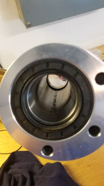

I am getting ready to replace my rear axle with a new Lonestar unit. I wanted to freshen up the carrier bearings at the same time so rather than pound out the old and in with the new I decided to just buy an entire carrier with new twin row bearings. Seems like a quality piece but I have a question about the inner spacer, it has a seam weld going right down the middle of it. The stock carrier spacer does not have any seam. It looks like the axle won't contact this piece so it is probably fine but just wanted to check with a few of you guru's first.

I've replaced mine (axle) few days ago. It is narrower in the middle so the contact point is only on the bearings. If the inner dimensions are the same as the old one (and they probably are) you'll be fine.

The spacer is to support the inner races from the pressure of the sprocket and brake hubs when the axle nut is torqued to max. The chances of the bearings coming apart is probable, unless you are using tapered roller bearings.

Exactly. The sprocket hub and brake hub they both "push" towards the centre and they sit on the inner ring of a bearing. Here comes the spacer into play to resist those forces and to prevent damage to bearings. Without the spacer all the force from the axle nut is transferred 50/50 to inner side of both bearings. It shortens the lifespan and increases the chance of a more catastrophic bearing fail. I wouldn't dare to run without it.
You probably heard "for every action there is an equal and opposite reaction ". Even with tapered roller bearing you transfer force to the carrier instead to spacer and another bearing. There is more force that carrier has to deal with and since it is aluminium, with time it might cause warping or cause the bearing to become louse in the carrier. Either way its not good.
