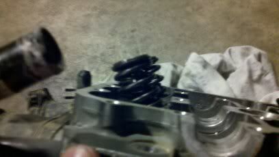

I bought a blown motor and was wondering if there's anyway i could tell if it was safe to use some of the parts i found. I was told the motor blew due to lack of oil. Upon looking at it more closely in my garage i noticed that one side of the decomp mechanism was broke. The piston moved freely before i took the cylinder off...So it didnt seize up. I bought the motor with out the clutch side components and without the valve cover :( who seperates those anyway! but whatever. There's a little rust on the cam and springs. I know so far it had a wiseco piston, HR cam and springs, HR con rod. Will a stroker crank have any identifying marks on it?

did you buy the cam cover? it is a matched set? are the journals for the cam scuffed? how much rust is in transmission? that engine looks like it has seen some weather open. you will need to completly disassemble the engine for a complete inspection. Post pics on the parts you would like to use.
Where did you buy the engine, maybe they still have the valve cover, you will need it to use the head................

It looks like a Wiseco 11:1 piston. If it is then it is a stock stroke crank. No identifying marks on the crank but if you compare the lower rod pit to another crank you can tell if it is a stroker. But the 11:1 wiseco only fits the stock stroke HR cranks.

Yes i also believe it was exposed to some weather. The only parts i want to use is the cam,springs,and connecting rod. Maybe crank if it's a stroker.

It is a wiseco piston, but I thought wiseco makes a stroker piston too? And if you look closely you can see a small ring around the top of the piston which leads me to believe that this is already a 102mm piston. And the combustion chamber hasnt been machined to match up with the cylinder. I could be wrong tho. This is the first motor I've ever taken apart and expected closely. Any tips and techniques that help with this process are always appreciated.

I have never seen weisco make a stroker piston but I could be wrong. I know JE and CP are the ones that make them normally. If you still have a stock rod I would run the HR crank. If you measure the piston that will tell you the size. You don't normally machine the combustion chamber to match the piston though.

Remove the piston from the rod, scub the top of the piston using a wire brush, there should be a number on the top. This will tell you what you have. Pull the lower cases apart, remove the crank, you will want to have machine shop check the bearings on the crank. while you go the machine shop take the cam with you, from the looks of the valve springs, the cam is not stock guessing from the picture it is a hot cam. They should be able to polish the cam journals.

You are correct i was looking at this picture and thought that it was a wiseco piston but its not.http://cgi.ebay.com/ebaymotors/Hot-...ors_ATV_Parts_Accessories&hash=item3f0d038a84

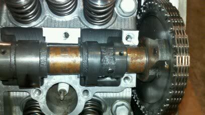

Yes it's a hot cams and im thinking it's a stg2. I used some oxy clean and a soft rag to clean it up a lil and it doesn't look to bad. I'll be taking the motor apart later today. And I'll take pics of everything when i do.
Here's some pics of the cam after i cleaned it up a little.
