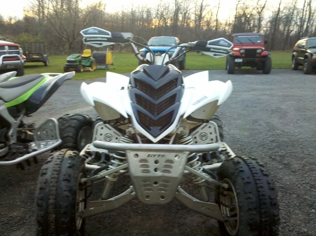

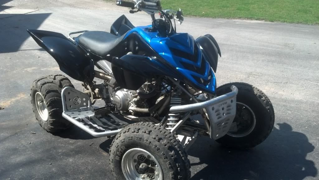

well guys it finally happened. the old scratched up white plastics finally bothered me enough that i took matters into my own hands lol. now its deff not perfect as i didnt want it to be knowing its a apaint job going onto a quad thats getting riden not shown but i do like the way it turned out now just to hope it stays! lol solet me know what yall think thanks!
Before
After

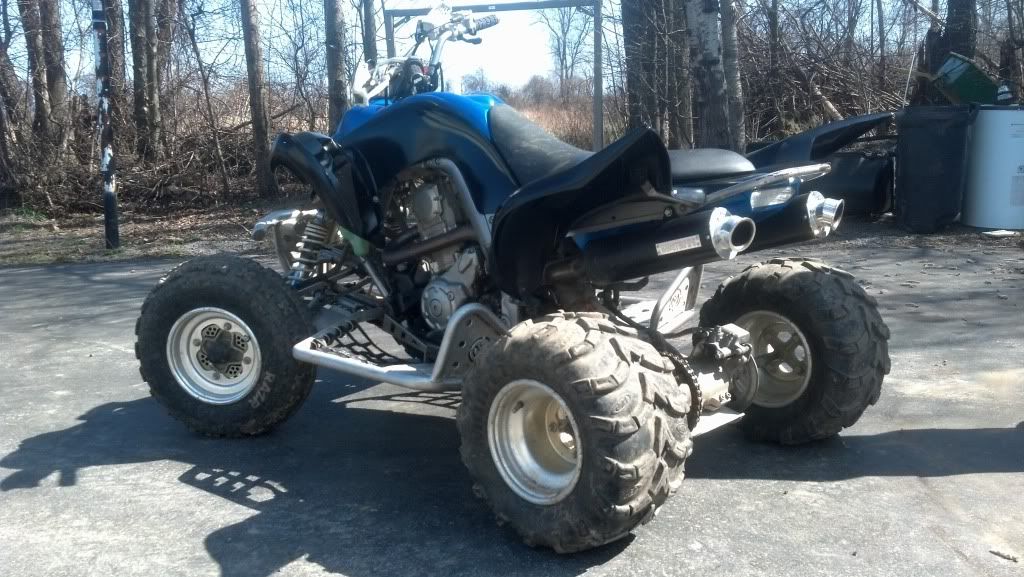

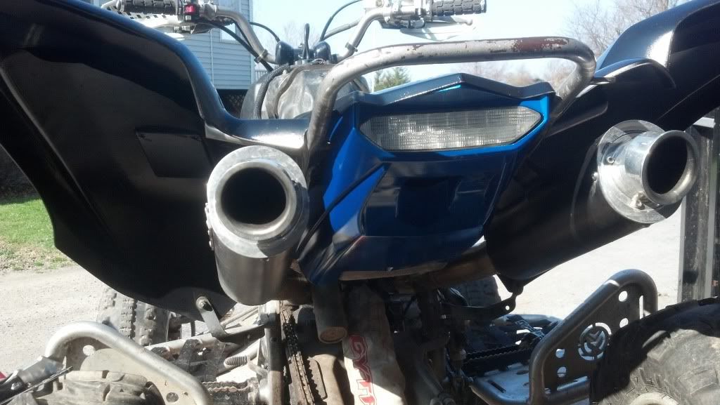

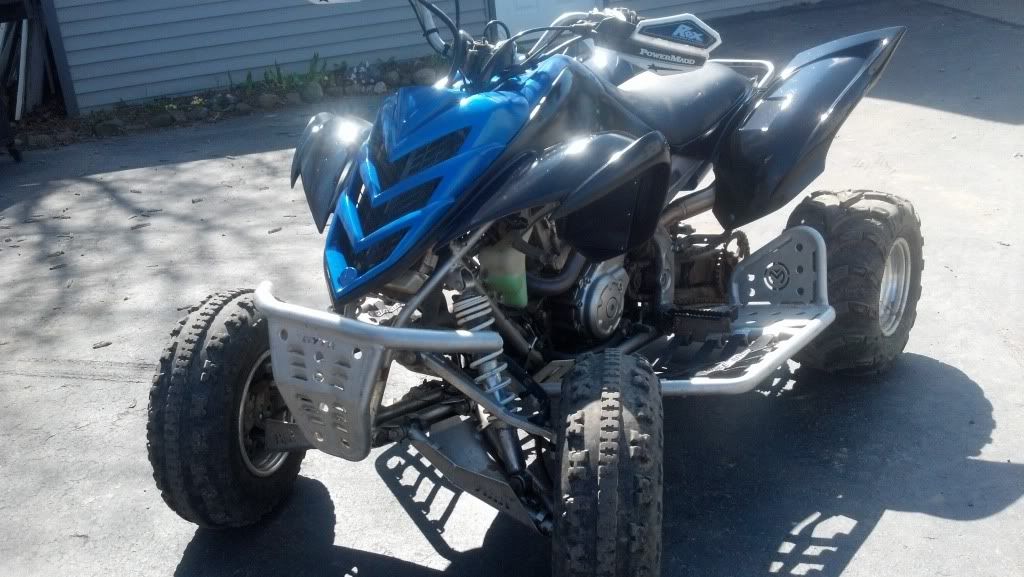

heres the hood done up on the old white fronts for kicks lol
the hood after fresh paint
and one last good full shot
dont be afraid to give me yalls opinions. might be blacking out some more stuff tonight and if i do ill get some pics posted asap
