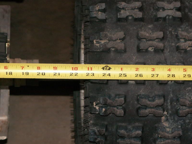

One of my son's Christmas presents was a pair of the G-Force extended rear wheel hubs. We installed them Monday night before our ride Tuesday morning. We went for a 30 - 40 ride from Lake Pleasent to almost Wickenburg. This ride consists mainly of graded dirt roads, somewhat graded washes and we just happen to find a few jumps along the way.
At first impression I am very happy with the purchase and performance of these extended rear wheel hubs. Now I wouldn't go doing any freestyle riding or big jumps with them, but for the average weekend warrior its a great alternative to buying a racing axle for $200 - $400. They increased the overall width by almost 4" (like the G-Force rear axle) but for the cost of only $ 80.00.
Here are few before and after pictures:

they look great. the extra wide stance sure is nice. i had to put on a new axle because i bent mine a little so i when with the g force axle. it is rocky mountain atv house brand and it is pretty good stuff.

I have GeForce spacers, but not the hub type like that. Those are cool. I've run mine for about two years now. I've done some jumping and so far have had good luck. But I don't catch a lot of air like some of these crazy guys do. GeForce is definitely a good cheaper alternative to an Extended rear axle if you do a lot of trail riding and light jumping.

all extenders like that, that isnt a axle has a greater tendacy to break, i jump mine, but its not like huge jumps, i have yet to see anything wrong with mine though, i have jump a good bit with them. the geforce ones probably wouldnt be so bad since its made out of a metal, mines made out of polyurathane, but pick and choose. :thumbsup:

Spacers, especially the bolt-on kind, add more bolts and connections which means more places they can fail.
Spacers of all kinds, including the hubs, put more pressure on the stock axle because of the extended length and leverage. The stock axle isn't junk, but it's not as stong as any of the aftermarkets.
