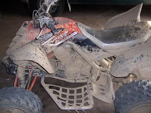

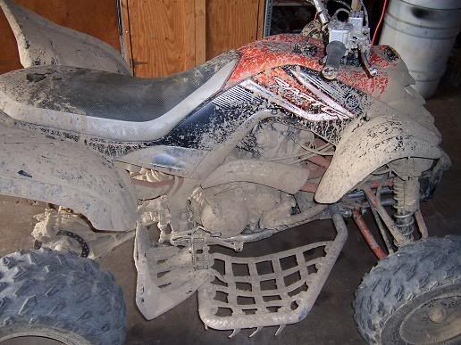

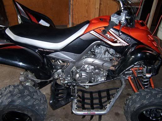

i'll take pics of my raptor before i wash it today and post them later.
before the bath
and after the bath.

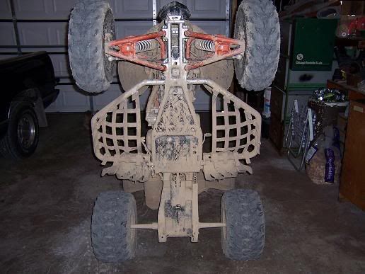

i took my skid off to clean they are back on now.
has anyone snapped a skid bolt off in the swingarm? if so then how did you fix it. i broke mine putting it back on. it's in the back of the skid so nothing will get up under it still but i want to get it fixed. any ideas?
Looks good dirty and clean. :thumbsup:

If the bolt is still in it you'll have to drill it out with a small drill bit being carful not to go into the threads. Then whatever size hole you make put in a metal screw without breaking itand try to back it out. If it doesn't engage enough put red loctite on it let it sit overnight and try to loosen it the next day.
689 Posts
Don't you love how the mud just bakes to the head pipe. Looks like you had a good time. You can do as the Dr. said or drill it out next size up and run a tap through it. I even think some brands tell you to do that in the instructions. Good luck.
226 Posts
How do you get it so clean. No matter how long i wash mine i can never get it that clean!!! To get the head pipes clean i use a scotch bright pad or a stainless steel brush. And also drill a small hole in the broken bolt and use a "easy out" and use the easy out in a drill gun and it will back the bolt out.

we have a set of easy outs around here i think i will try what everyone said and drill it then put the easy out to it. thanks guys.

My skid bolts did the same thing. One broke off on the trail and the other when I took off the skid to clean underneath. Ended up drilling the ends and using an easy out type tool. With dad's help of course. We ended up drilling the holes and retapping them from a 6m to an 8m. Got some 8m bolts from Lowes and made some sleeves for the bolts. They SHOULD hold up better now but we'll have to see.
