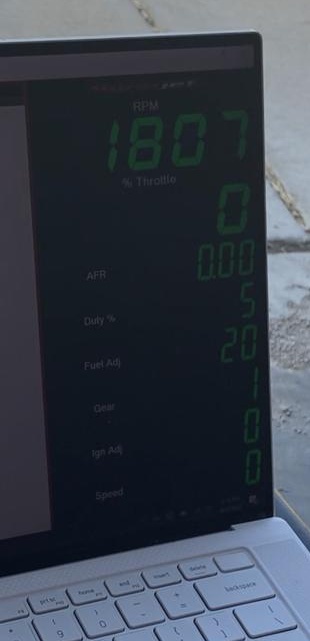

When looking at the power commander, what does the Fuel Adjust mean? This is while idling.
Mine is showing 20, and was mostly curious.

What exactly does Fuel Adj mean??

+20 sounds pretty rich at idle for 0% throttle. I'll have to check mine and see what it is.
