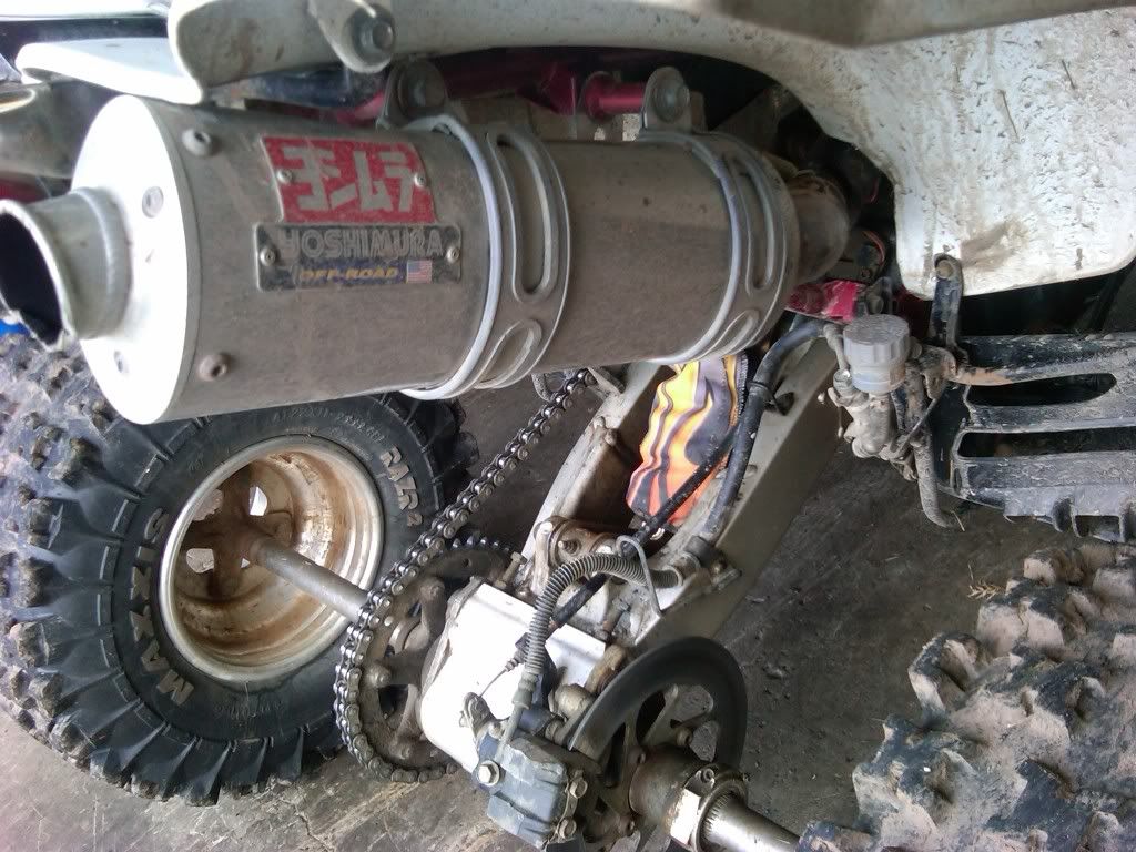

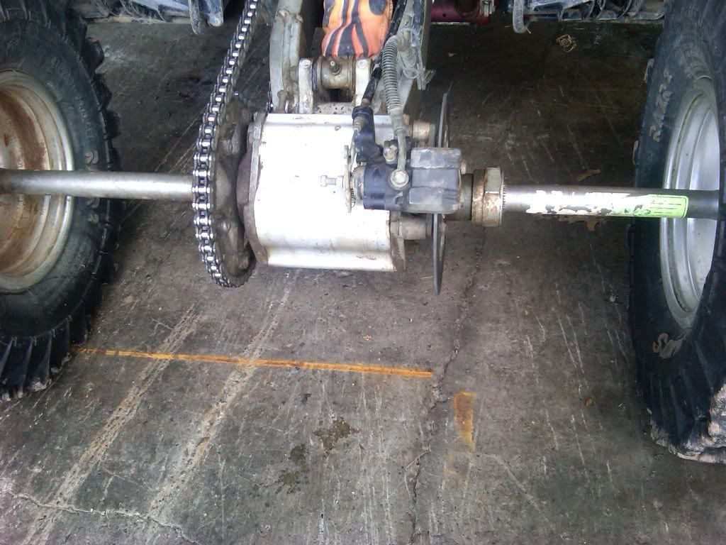

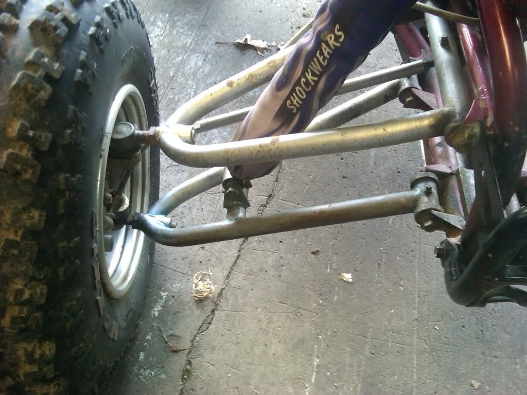

I am a newbie so go easy on me. I just picked up an 04 660r that has seen better days but I plan to fix it up and get it back to proper condition. I am a sled guy so I am not real knowledgeable with wheeler mods so I am hoping you guys can help. A-arms look after market to me becuase I want to replace the ball joints but the stock ones are different. Any ideas what these a-arms are? The bottom one measures just around 15.3 inches from center to end. The exhaust is way to loud but I am hoping to be able to repack it to tone it down a bit. The rear axle also looks after market but I am not sure. The kid who I got this wheeler from said it has the following but I am not sure how accurate the list is: 2004 Raptor bored out, stroker kit, stage 2 jetting, aftermarket crank, wisco pistons, E47 exhuast, aftermarket axle and axle hubs with spacers. handle bar riser etc... I have no way of verifying the engine mods without pulling it apart but in the meantime all of the bearings in the hubs are shot and the ball joints are loose so I want to start with the suspension but I am already wondering where to find these aftermarket ball joints?

Welcome to the forums! I think they are ASR a-arms, I think I have only saw those bottom brackets on the ASR a-arms. The axle is aftermarket, but not sure on the brand. I like sleds also:D quads are totally different, good luck:thumbsup:

I'm guessing on the a-arms, but most of the sport style asr's have heim joints on the lower a-arms where it attaches to the frame so I'd guess you have Armadillo a-arms
The rear axle is a durablue eliminator. The exhaust is a yoshimura, perhaps an RS model.
The air filter is a K&N drop in filter that has been installed upside down and screwed in place. Not a preferred setup to say the least. I'd replace it with a Pro-Design clamp on filter kit. The K&N filter on the crankcase breather vent is fine.

I would also check into lonestar on them arms, they look just like mine and that is what i have. The exhuast looks like yoshimura rs3

i dont think the arms are armadillo,same color but armadillo arms are shaped differently.
To find how wide it is just measure it and look up stats on google, chances are its a +2

I think ASR Long-Travel a-arms have the bottom like what Thundercat has.

to quiet it down buy the silencer for your yoshi exhaust. its only 20bucks and it made mine so much quieter. And looks like you have the yoshimura rs-3 exhaust.
