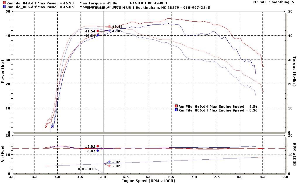

I brought my quad to EHS Racing today. My trail ready quad is really heavy and seemed a little sluggish. I have seriously been contemplating doing some motor work, but figured I should get a decent tune first. I had a pretty good map to begin with, but Erik was able to find a little more, especially up top. I have a stock motor, +3 TB, PC-V, dynateck, Velocity filter and DMCs. Heres the chart

how does it feel.. i bet you wanted 50whp right? with the ignition and +3TB i was hoping you got it too.. cause thats what i plan on doing next

I havent had a chance to ride it yet. But Honestly, I didnt have any HP expectations or desires. I have my quad geared up to stay in 3rd and 4th longer, so I was hoping for some more bottom end. I would like to be able to gas the front end up a little easier. Unfortunately I dont think i got it. I think i picked up a lot of power in the higher RPM range. Im not concerned with the numbers, but the ride will tell. We did talk about a mild trail build if this dosent do it for me.

Eric's dyno is stingy and does not give big numbers very easy....so it seems like you are in the ball park to me, and you are right eric is a great guy to deal with.

Im guessing the blue is when you came in and red after tuning? If so you definately got yours money worth out of that tune! Bet it runs way better

I made 2 maps for 2 different timing curves, so it cost $220. I could have gotten away with $160 for 1. For the 2 maps, He must have done 30 runs, or 10 with 3 different files, 1/4, 1/2 and WOT.

Thanks, I got to ride it for the 1st time since the dyno yesturday. There was a noticable difference, especcially up top.
See people a nice tune is well worth it over a pre loaded base map or someone elses base map with same mods.
