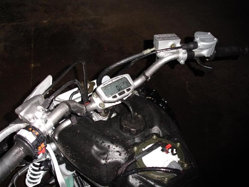

If this helps at all, I moved ours to the hole in the left headlight assembly. There is a hole in the alum fram thingy. Works well for us. Plus its out of sight! If you look in this pic below the headlight switch assembly, you can see the key sticking out there..
ahhhh nice i might try that too scott. mahalo for the help
