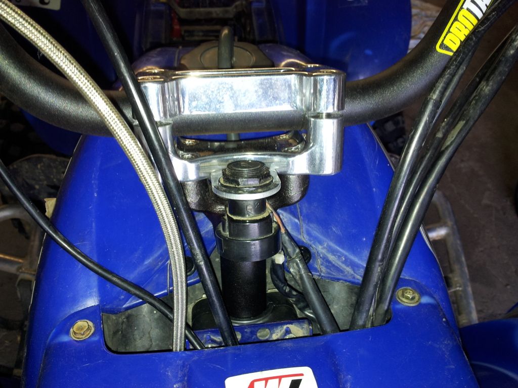

Let it sit garaged over the winter and early in april I got it out again and started to get it ready for this season and found this.
found a good used and straight steering stem out of an 03 and started the replacment and ran into this.
soaked it for 2 days with penetrating oil, did a search on these forums and found some excellent advise on getting this out, a 1 1/8 nut and my impact wrench and it came right out. Replaced the lower bearing and seals, packed it all in grease and installed my new shaft.
