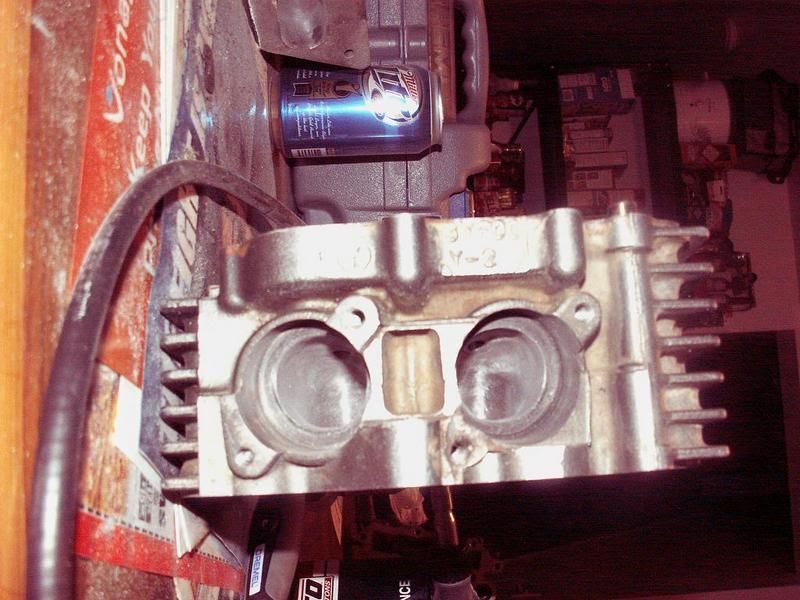

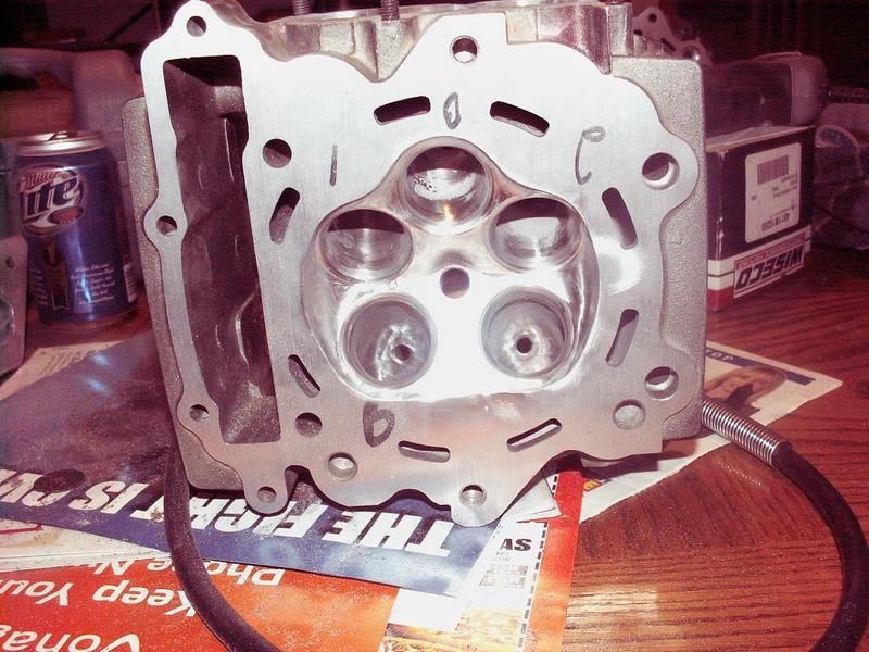

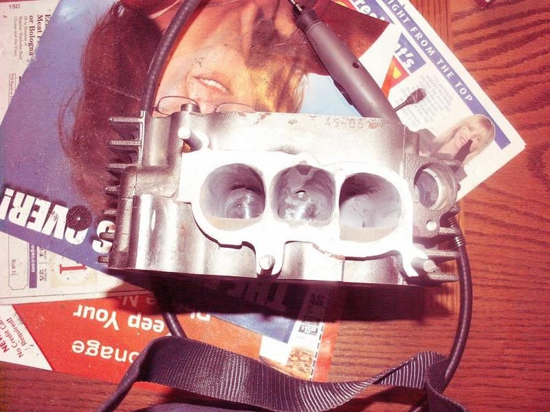

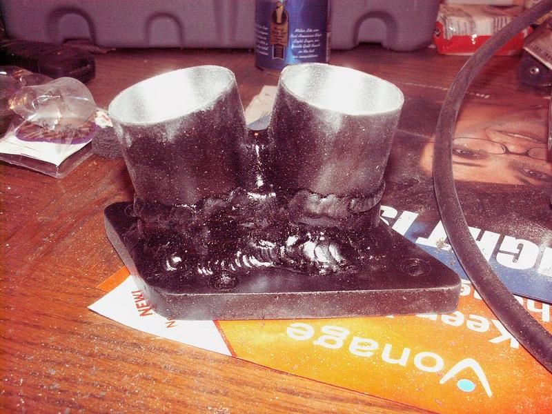

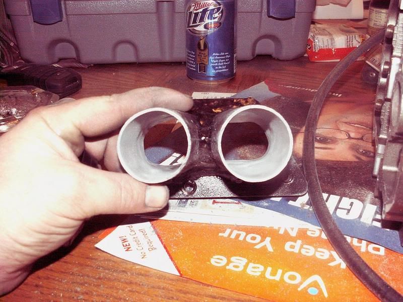

well i am new to this site so i thought i would kind of introduce myself and the project i am working on. ok well here it is. I designed the head to be three differrent intake runners because I dont like how the center intake valve gets fed, so I totally hogged it out then had tim barker weld in the runners for me and mike from coalshed racing did the epoxy work and most of the porting, I finished the porting and I polished it. the intake is a bit differrent now (it started good but the guy I originally had weld it screwed it up real bad so tim showed me a little bit of tig welding and I finished fixin it, not pretty on the outside but it is on the inside, I cleaned it up on the bridgeport, and the head is a bit cleaner than it looks, the ports dont look smooth but they are very smooth. since i took these pictures i had put the engine all together minus the automatic decompression. then i found the starter wouldnt crank it fast enough without decompression so i took the head back off and installed an manual decompression valve in it. i finally got it running the other day but the jetting is off pretty bad so i need to take it to the dyno. oh and my engine is a 719 with wiseco 11:1, stage 2 hotcam, barkers 4 mill crank.
intake
exhaust ports
bottom of the head
intake ports
