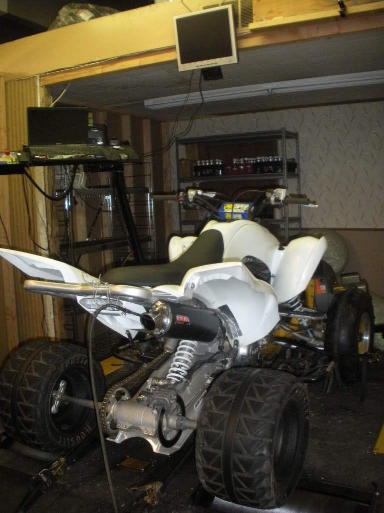

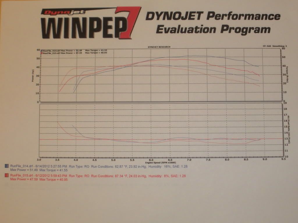

So here is one dyno test of a before and after Stock cam vs. Hot Cam stg 3
Mods....
Crappy sticky TT tires...
6500ft elevation
90* temps...
06 700r stock motor.
Bub pipe
MSD Blaster
WK Intake.
stock = 47.59 hp
HC3 = 51.49 hp
+ 3.9 hp at peak
stock = 40.95 tq
HC3 = 41.55 tq
+ .6 tq at peak.
Peak gains are not as noticeable as after peak.....
At 8000rpm there is a + 11 HP gain and a 8+ 8 TQ gain.....
This was a throw it in there and test it, test. I have a BB high comp build planned for it.... later on.

This was exactly what I was thinking... just throw the cam in there for now till I get duals, and head work..... I think it was a good increase for how I ride. It lost 2hp under 5k rpm, but I think the 3.9hp at peak and 11hp gain at 8k is well worth the 2hp under 5k. IMO.

So I added the WK intake and MSD. Then we used curve #3 as our base map, and then tweeked it on the dyno. We didn't have but 30min to tune it, soI know it isn't perfect but good enough for now.

The HC2 will be perfect for big 3 set up. More so than the HC3 when you don't have head & piston work. You really feel that cam going about 150 ft down a 300 ft drag!
128 Posts
So you're saying that a Hotcam 2 is better than Hotcam 3 if you don't have any head work done?
I have a Dynatek EFI, GYTR intake & Filter, Dual DMC Force 4's and HC3. If I were to downgrade to a HC2, I would notice MORE power?
23 Posts
In theory you should pick up some low end power/ grunt.
Long duration cams bleed off compression in lower rpm ranges..... it is this same affect that is what helps high rpm cylinder fill.

If you include the stock piston I mentioned, in addition to headwork, then yes, that's exactly what I'm saying. Makes sense when you look at both aspects, and not just one. :)
