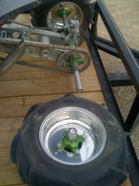

I've got a built 06' R6 engine on my bike, aprox 135hp. I took it out to St. Joe this weekend to do some sand dragging. I was runnin side by side with alcohol banshees, hitting right at 90mph each run. The 4th run as soon as I launch, this happens! Luckly it happened at launch and not at 90 mph! I believe this is an "RAD" axle, not really sure since it came with my swing arm. anyway, its an RAD carrier, what axle will fit in here? Not sure about that, and what will hold up to this power? I dont want to chance this happening ever again. the bottom one is actually a video

Axle wasn't designed for that much torque - you indeed are lucky it didn't fail at speed.

The highest torque in the axle is on the launch, after that it diminishes, your chances of breaking the axle at 90 mph is near impossible.........
Agreed - but twisting it at launch, causing a small fracture, which then breaks when hitting a bump at speed IS a possibility, albeit lower likelihood.

the fact that you didnt strip teeth on the sprockets, break a chain, hurt the trans, or just flat out spin, is amazing. glad ur ok, it coulda been waaay worse. that axle looks like it sheared perfect, i cant tell but does it have an outer and inner piece? forgive my ignorance, but the picture could be playin a head game with me...

its a solid axle, the ends are notched for the hubs and the part that is on the wheel still has two spacers which are to be used to make it sit wide or narrow, and that is right where it twisted clean off. Poor design IMO.

Wow! I would have thought that it would strip out the hubs before it sheared the axle, but I guess not. I had a hub strip out and come off with the wheel, but was in third gear when it happened. Its extremely scary when you see your wheel pass you.
