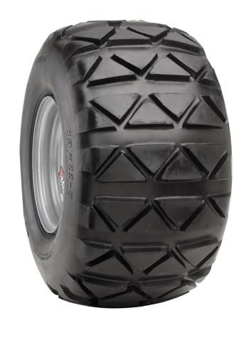

I'm gonna lower her with the CFM lowering kit I got from Devin29. Then take her out to the local 1/2 mile track. I got some 20/11/9 tri trac duro's on rear
and 21/7/10 duro tri-trac front
I was wondering what's a good gear for this track size so I can run fifth gear. Right now I'm gear 15/36 should I re-gear if so to what. I'm just doing this for fun as I still trail ride and do a little gncc, a drag racing. My engine produce 80+hp and 60+ mods are 778 bigbore stroker with true 54mm TB from WK, 13.25:1 compression counting extra from stroke DMC duals custom web cam, Cuervo extreme +2 port work, PC5 custom tuned by Eric @ EHS racing! Any help would be great. Anybody ever run this tires they are supposed to be a a dual sport asphalt/dirt tire pikes peak riders use

15/36 will be to short of gearing, go no minimum of 15/38. But honestly I run 15/40 and runs very well. I've raced many 1/2 mile oval tracks and this is my gearing recommendations. Also with you running a 20" tall tire the 15/40 will be more like a 15/38 on 18" tall american racer dirt track tires

The 36 gear in theory will give more top speed, but the motor wont pull it in 5th gear all the way to rev limit. A 40 will give you as much speed as the 36 would only because the 40 allows the motor to rev up higher allowing you more low end pull coming out of the corner. When I ran a 36 my speed coming into the turns was 91 mph, when I ran 40 I was coming into the corners at 93 mph, and had much more out of corner pull.

In what gear? 4th or 5th.. and with what sprockets? On 1/3 mile tracks I run 15/38 and run 4th gear. On 1/8 mile tracks I run 14/38 in 4th. We don't have any 1/4 mile tracks around here to know what gearing to run
1/4 mile drag strip I bounce off rev limiter in 5th at 15/36 with 22" asphalt tires.
